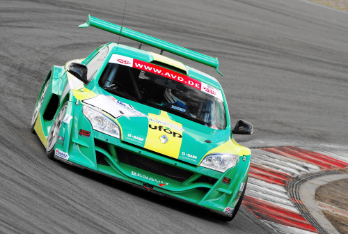

Green racing. The Renault Mégane Trophy BioConcept Car employs natural fibre composites and is fuelled by biodiesel.

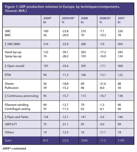

Figure 1: GRP production in Europe, by technique/component. (Source: AVK.)
In 2009, GRP production volumes in Europe are expected to reach 815 000 t (Figure 1), about 30% down on 2007. (However, Witten notes that over shorter time frames, information obtained from raw materials producers on which this data primarily relies may deviate from the volumes actually processed during this time period.)
The demand for, and production, of thermosetting component parts made of SMC (sheet moulding compound) and BMC (bulk moulding compound) were affected by developments in their main application markets – automotive and electronics/electrical equipment. Vehicle production decreased by as much as 50% in some cases, accompanied by even greater losses in the truck sector, necessitating a structural reorientation of the key players in this market segment.
Processors using open moulding techniques (hand lay-up and spray-up) have been hit hard. At the same time, the contribution of these processing techniques to the entire composites production volume has dropped from almost 30% to less than 25%.
Closed moulding (resin transfer moulding) has seen less of a decline. This may be attributed to the substitution of open moulding techniques as well as the low-volume production of component parts with large surface areas.
The market for pultruded GRP profiles in particular is holding its ground relatively well, primarily as a result of new infrastructure projects.
The partially publicly funded building sector (including EU subsidies), as well as new sales territories (especially in Eastern Europe) have slowed the decline in the GRP pipe and the tank building sector. Select niche markets, such as sewer lining, continue to realise high growth rates.
Production of thermoplastic moulding compounds and semi-finished products depend largely on the development of the automotive sector and are showing corresponding setbacks.

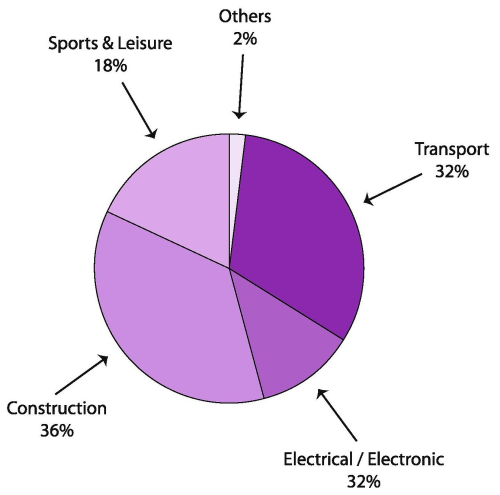

According to the AVK’s statistics, the breakdown of the European composites market in terms of application industries is in general much the same as in previous years (Figure 2). A slight decline in the transport industry has been compensated for by a minor increase in the building sector. In general, the recession in Europe has affected almost all areas of application to a similar degree.

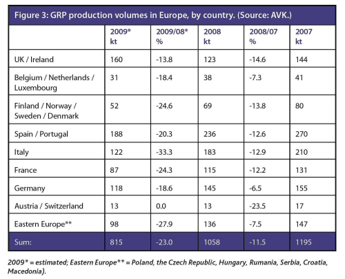

Figure 3: GRP production in Europe by country. (Source: AVK.)
The distribution of the total GRP production volume over the European countries included in the AVK analysis is shown in Figure 3. Heading the list of large players in the European market are Spain, Italy, Germany, the UK and France, whose share in the total volume has increased from approximately two thirds to almost 75%.

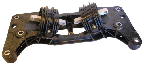

BMW's composite cross-beam.
BMW’s award was for the development of a composite transmission cross-beam. Until now transmission cross-beams for BMW cars have been made of diecast aluminium. The part is required to fulfill performance characteristics such as operating strength, heat management, acoustics, and crash behaviour. To reduce the part's weight BMW wanted to see if it was possible to make the component from glass fibre reinforced plastic.
A selection of composite materials were evaluated, and the injection moulding technology using polyamide (PA) 66 and 50% glass fibre was selected for further development.
The first application for the composite transmission cross-beam is the new BMW 5Series GT. The space required and mounting concept are identical to that for the aluminium part previously used. The weight reduction achieved is approximately 1 kg.

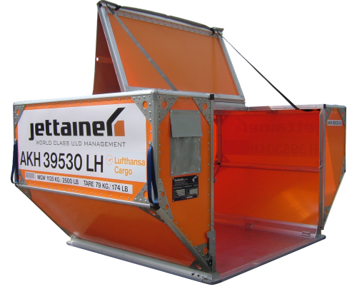

Following two years of trials, DoKaSch, a manufacturer of air cargo equipment, introduced the AKE Iw-65 air cargo container, which is made using RP10 composite panels employing DSM's Dyneema® fibre and Aeronite® resin. The container is around 20% (15.5 kg) lighter than standard aluminium containers, leading to reduced fuel use and emissions. The RP10 panels are also up to four times stronger than aluminium sheet and have excellent resistance to impacts and wear and tear which helps to lower maintenance costs.
Based on the success of the AKE (lower deck) container, DoKaSch has added the AKH (main deck) container to its lightweight container range, and this also employs composite panels.

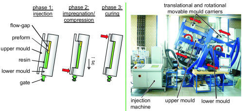

IKV's gap impregnation process.
The Institut für Kunststoffverarbeitung (Institute of Plastics Processing) at the RWTH Aachen (IKV) won the University category for studies into the automatic and large-series production of continuous fibre reinforced plastics parts by the gap impregnation technique (a variant of resin transfer moulding).
The gap impregnation process is a means of speeding up the impregnation of the preform. Unlike an RTM mould, the geometry of the mould cavity can be changed during the process and a flow gap for fast distribution of the resin can be created on top of the preform. To achieve high fibre content the preform can be compressed by a movement of the mould sections.
A prototype gap impregnation process was developed at IKV in cooperation with Hille Engineering. It has been demonstrated that parts of dimensions 500 x 500 mm2 with fibre volume contents of 50% can be manufactured in cycle times of under 10 minutes. Impregnation and compression only take 19 seconds, a significant reduction compared to the RTM process.
IKV believes this process would be of benefit to the automotive, transportation and aerospace sectors.

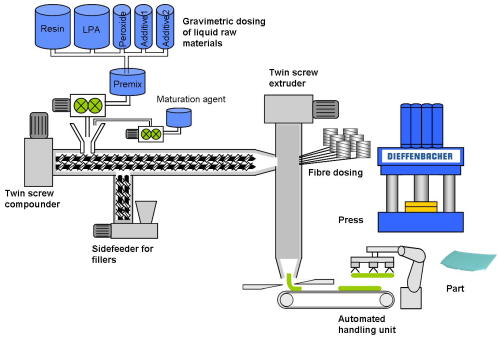

Also focussing on innovation were DSM Composite Resins, Dieffenbacher and Fraunhofer ICT, who unveiled a direct compounding technology for the production of thermoset composite components.
The new technology is particularly suited to the production of geometrically complex, large (greater than 3 m2) parts in high volumes (approximately 700 000 units per year). The organisations believe the process will open up new opportunities for thermoset composites in replacing metal materials in the automotive industry and other markets.
The result of many years of research and development in European project, the technology has been realised through a strategic cooperation between the three partners. Dieffenbacher, a German manufacturer of press and production systems for processing composite automotive components, developed the hardware systems and expertise. The Fraunhofer ICT industrial research institute of Germany provided R&D and pilot processing capabilities. DSM Composite Resins, headquartered in Switzerland, contributed resin formulation expertise, including the development of a product portfolio of non-thickening resins.
The direct compounding process for thermoset composites unveiled by DSM Composite Resins, Dieffenbacher and Fraunhofer ICT.
A pilot plant is currently operating at the ICT. The first production line is in development and should be operational in the second quarter of 2010.
The technology can produce moulded thermoset compound materials in a continuous and flexible extrusion process (see diagram). Key features include a computerised dosing system yielding better quality consistency and reproducible fibre impregnation. The process results in shorter cycle times through just-in-time production and eliminates a range of steps in between such as paste mixing, thickening and storage compared to conventional thermoset compounding processes, saving time and making part manufacturing more economical.

For its pioneering work in the area of natural fibre reinforced plastics, the BioConcept Car project of Four Motors GmbH was presented with the COMPOSITES Pioneer Award 2009. The body of the BioConcept race car is made almost completely from bio-composite materials: doors, mudguards, bonnet, bumpers, wings and the boot lid are made from natural fibre reinforced plastics. It is fuelled by biodiesel.
Race car team Four Motors GmbH of Reutlingen, Germany, first used a racing car with a body shell made using plant fibres in 2006. This first-generation BioConcept Car was based on a Mustang GT RTD. In 2009 the concept wad developed further in a Renault Mégane Trophy 09. In cooperation with the Nachwachsende Rohstoffe eV (Agency for Renewable Resources) and the German Aviation and Aerospace Centre (DLR), the car’s glass fibre body shell is currently being replaced step by step with parts based on natural fibres. The natural fibres are combined with liquid bioplastic (linseed oil acrylate).
Both cars will take part in upcoming long-distance races.
Both generations of the BioConcept Car – the Mustang and the Renault Mégane Trophy – were on display at COMPOSITES EUROPE 2009.

DoKaSch air cargo container manufactured from composite panels.
